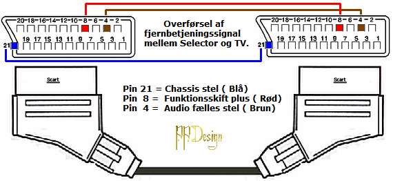

    It is correct that the STB controller "listens" on pin 8 of the SCART, this pin tells the tv if the connected box is on or off.
    This is not possible to do if the box/ps3/pc is connected via HDMI. But this is not the problem as i see it, if the STB is turning the TV off, then it should do it the "soft" way, with curtains and all, and not the "hard" way, like the power has been switched off.
    I am using a Sagem ICD-60-04 as DVB-C decoder in Denmark, and this is connected via SCART, so i don't have the issues you are describing.
    /Weebyx

  • 07-25-2008 3:29 AM In reply to
    Re: BV7 40 MKIII / SW 4.24 problem
    You must have a SCART connection to you DVB-C tuner, Luck on thes linck.
    http://www.hifi4all.dk/forum/forum_posts.asp?TID=42140&KW=B%26O&PN=0&TPN=16
    .( Google Translator http://translate.google.dk/translate_t?sl=da&tl=en )
    .I have also SW 4.24a and it works well.
    Peter Pan

  • 07-25-2008 5:58 AM In reply to
    • Seanie_230
    • Top 75 Contributor
      Male
    • Joined on 04-20-2007
    • Milton Keynes, England
    • Posts 962
    • Gold Member
    at lunch time today i am popping home to connect a cable between pin 8 & pin 21 of my scart conenctions to see if this solves the problem with the tv turning off and weird happenings on the STB controller.
    i will inform you all of the results in two hours time

  • 07-25-2008 8:18 AM In reply to
    • Seanie_230
      Male
    • Posts 962
    • Gold Member
    and for my reply............
    switched scart conrtol on
    connected pin 8 & 21 on tv and sky box
    STB controller works perfectly every time
    im not sure if this has cleared up the turning off issue but i imagine it will as for some reason for the STB controller to work with a sky box it needs to detect the 5Volt signal from the STB, which i think it rubbish as the tv is connected with HDMI why woudl i want to run a scart lead.
    i connected a 5V feed to the tv and ignored the sky box all together and it still worked perfectly so bang & olufsen need to stop blaming sky and come up with a solution to this problem rather than sitting around finding someone to blame.
    i have left the tv on at home and told them if it turns of to call me ASAP so i can check to see weather this 5v problem is cauing the tv to turn off also which i think it may well be.
    I am shcoked that the STB still has to reply on scart to autosence that is shoudl do its tasks?
    Thanks hope this helps at least one person
    Weebyx:
    seanklemis:
    i had a call from a dealer today to say that it its prob being caused by the pin issue with pin 8 of the scart lead not being conencted this does sound liek ti coudl be the problem the sky box turning off and tv turning off, i cannot believe i have to possibley put a scart lead in to usemy tv on HDMI
    /Weebyx
    why woudl the STB listen to scart of the TV is using HDMI not a very clever set up, without the 5Volt signal the STB controller seem to behave any way it feels fit lol.

  • 07-28-2008 5:54 AM In reply to
    • Seanie_230
      Male
    • Posts 962
    • Gold Member
    Monday Morning Update
    If you have SKY conected to the TV using HDMI you still need a scart lead for the STB controller to function as if its not conencted it causes the tv to act in a weird way turning itself off and not working properly with the sky box
    also this is set up this way as if you have a link room tv you cannot broadcast the signal from hdmi to link rooms this is done via scart as HDMI is copyright protected.
    all in all if you use STB and things go wrong connect scart lead, my tv has been ok since friday.
