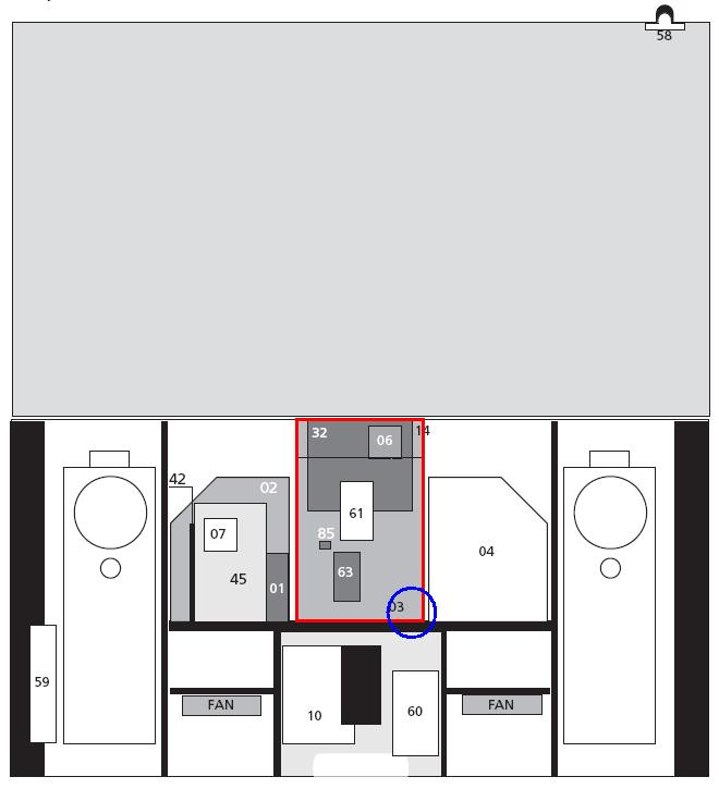

    As far as I know PCB80 and 81 are inside the motor stand.
    The cable should fit to socket P458 (see picture below - somewhere in the
    blue circle) on PCB3 (red square).

    Well thats explains why I can't find it Smile PCB 3 is not easy to get to.

    Gerd, you are awesome.  I have connected them up and it is fantastic. Thanks guys.
