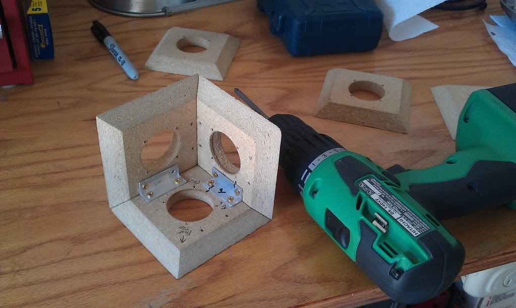

Evan:Marked and drilled the holes, 1.5" hole saw.
More, MORE, More

Søren Mexico:
More, MORE, More
I'm trying Søren! My internet keeps giving up right as I post a new pic...

At this point, all of the cube panels must be aligned. Also, all holes for brackets and tweeters must be made now in initial assembly as these are going to get a few coats of black paint.
I had to fabricate all of the brackets (16!) myself as even the smallest ready-made brackets from the hardware stores were too large. They were cut from the sides of aluminum square tubing. They are numbered once fitted to ensure they are put in the same place in final assembly.

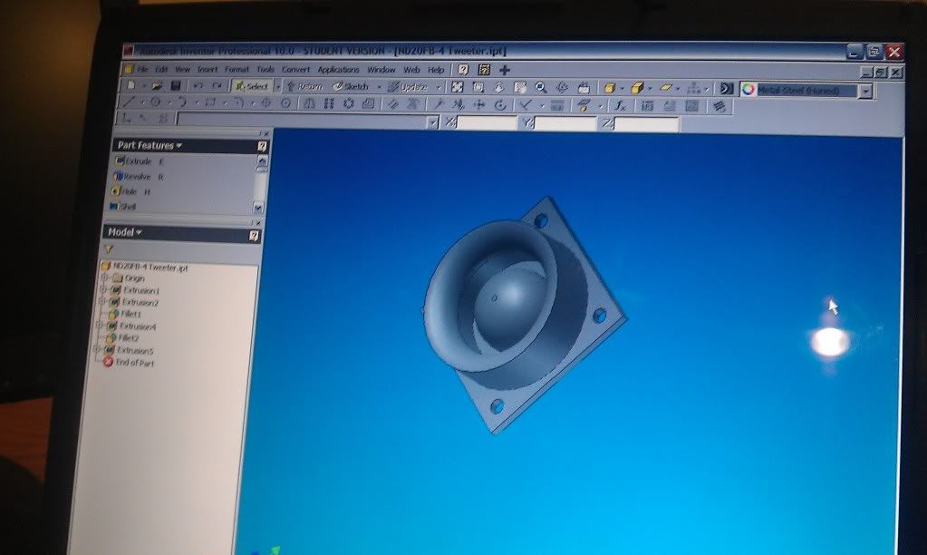

This is a little out of order but I'll throw it in anyway. Tweeter size and installation is confirmed.
Just like I planned.
