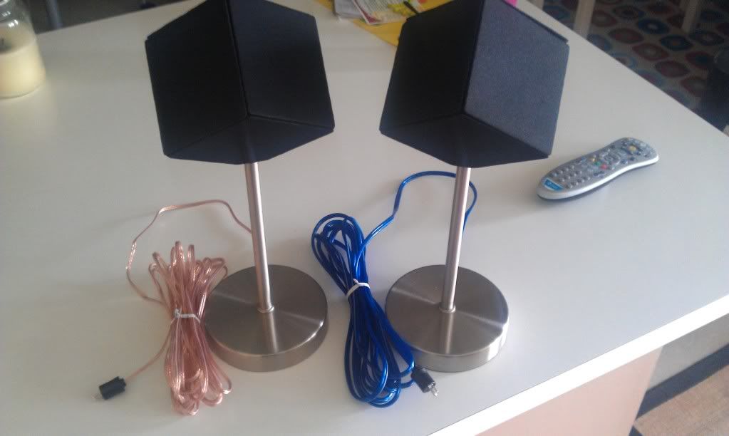

    Here they are wired up for initial testing in T-minus 2 hours. Those are, of course, not the final speaker cables. I will re-fit them later.
    Right now I'm picking out some treble-heavy tracks to get them warmed up!
    Evan

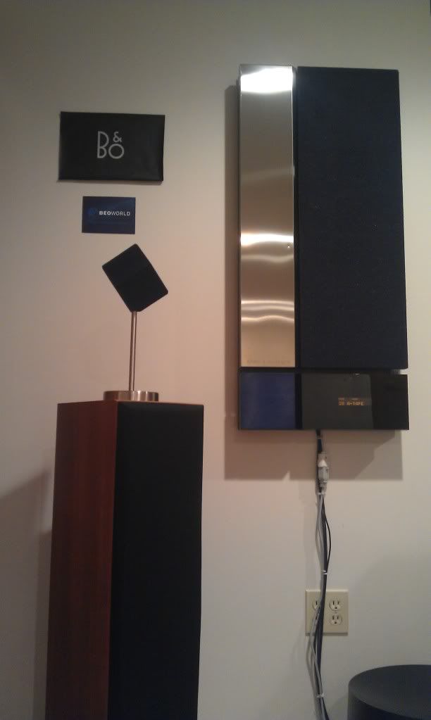

    Can't wait to see you're panels! My new 2500s will be connected to my 4500 shortly Smile
    Evan

    I am happy to report a successful first session! Not only do they work, but they work well!
    Lots of sparkle with these. Sound a bit tense but really only noticeable when you listen exclusively to the cubes. I'll be going back over tomorrow to let them get some more playing in.
    At first I started with a white noise signal to see if all the drivers were working and to check balance, you know, the vitals. Checked out fine.
    Started playing some tunes, through the cubes alone. The output is definitely less than I expected, Peter's similar comments about the original BeoVox 2500 come to mind. However, I am hearing more sound information than I thought I would.
    Alright, now that they've warmed up it's time to add in the main speakers. I started with the JBLs and Conas then added in my BeoLab 5000s. The effect is definitely present, there's treble everywhere! Near and far, they produce a spectacular image.
    After not too long I found myself going beyond 50 on the volume scale, these cubes are fun to listen to! I reeled it back fearing the units hadn't enough time to play-in quite yet.
    The cubes alone are running off my BeoMaster 4500 directly. I think this has a lot to do with the performace I am getting. Cymbals crashing, finger tips running down guitar strings and triangles flow over bass tones without distortion. Phenomenal!
    I cannot wait to go back and rock out tomorrow!!

    After listening to my tweeters for a while now, I thought I would give an update.
    So far I have only tested on the original design, cap values unchanged. Sorry, I promise I'll get around to putting those new caps in Rich.
    My biggest observation is that they are not beneficial all of the time. They work well - and are wonderful to listen to - on non treble-heavy tunes. Songs with lots of hiss and recording noise make the experience unpleasant, sometimes even painful to the ear. This is all probably sounding very obvious, but it didn't seem to cross my mind before hand.
    My observations were also confirmed by a fellow BeoWorlder, love and hate type of thing.
    The all-desired dispersion effect is noticeable, that's for sure. When appropriate, I always have these running! Very solid image.
    EDIT: I guess I should add in some thoughts about listening positions. The cubes certainly do help with my surplus of seating arrangements, the upper tones are spread well and suprisingly evenly.
    On the topic of dispersion, transparency seems related due to the extra tweeters. Having the ball of sound, gives the illusion of the sound actually happen in the room. They definitely have an effect of sense of space.
    Power handling is less than expected, when pressed, the 4500 keeps pulling them down to 76-78 on the volume scale. These numbers sound crazy, I'm sure, but my listening space is HUGE! Approx. 900 ft^2 / 84 m^2
