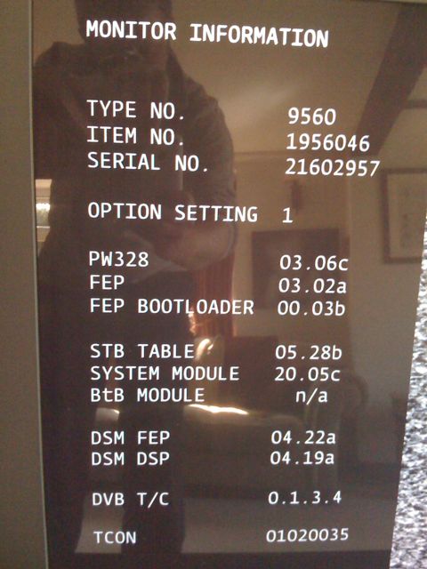

  • 04-16-2010 6:54 AM In reply to
    • Si
    • Not Ranked
    • Joined on 12-12-2009
    • Posts 21
    • Bronze Member
    Re: BV8 - BV6 link
    Bellow is the info on the BV8, the 6 will not let me do this but I think it is set to V.OPT 6
    Thanks
    Si

    Simon
  • 04-18-2010 10:43 AM In reply to
    Re: BV8 - BV6 link
    Si:
    We appear to have different BV8s, mine is a BV8-32
    I was checking the DVB software version numbers but they are a different format of version number !
    BUT I did notice mine is set to V.OPT 2
    Perhaps we should try that ?
    First B&O (1976) was a Beogram 1500 ... latest (2011) change has been to couple the BL11 with the BL6Ks *sounds superb*
