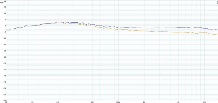

I used the same pickup unit and tested using 2 needle parts. The first needle parts was a original B&O where I have checked the diamond by microscope - all ok. I performed the frequency response test.
Next I changed the needle part to a re-tipped elliptical diamond - done by Axel, and the frequency response test once more. Exactly the same conditions.
The result:
From 500Hz and up the frequency response was clearly improved and with the higest result at the top end (high frequency range) where the improvement is more than 5 dB (this is a very big improvement)
The tonal balance is much improved and in the following listening test the difference was very clear.
See the frequency response here.
