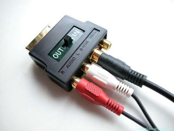

    I have a Avant 28".  I would like to connect it to my Projector to watch macthes from time to time. I have not found any video output in the T.V. Is there a way of using T.V signals from Avant and watching it through LCD Projector. Any advice will be much appreciated.. Shakeel

    You can use a scart adapter with an in / out switch that converts the scart socket to RCA and an s-video socket.
    Here is a picture of the unit i am talking about. We use one of these with our BV3 which is pretty much the same as the Avant, and for us it works perfectly. I hope this helps! Smile
