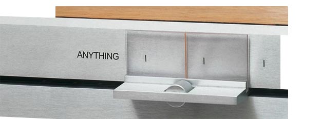

In the above pic you can also see the modifications I’ve made to the sliding controls; the left slider gives ‘play’, ‘stop’, ‘fast forward’, etc. controls, the right slider is used to navigate the MP3 player’s menu system. Connecting to the existing B&O controls was a lot of work. I used an old plotters linear encoder and an ADB mouse to register movement of the right hand side slider. This circuit plugs into the PowerBook’s internal ADB socket.
I had to make my own buttons for the slider because I couldn’t find any small enough. I filed them out of aluminum flat to match the front panel.
For the left slider I positioned 6 read switches spaced evenly along the length of the controller and mounted a magnet on the rear of the slider. As the slider moves back and forth, the read switches are activated. These switches, along with the buttons on the front of the player, are connected to various keys through the internal keyboard connector. The "OFF" button is an exception here. This button puts the PowerBook to sleep. It does this by using the 'sleep when closed' function of the PowerBook. It’s wired across the reed switch that senses when the PowerBook’s lid has been closed. The advantage of this system is that it overrides whatever else is happening and puts the machine straight to sleep. Wiring up the keyboard connector was a bit of a nightmare.
