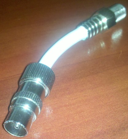

    Re: Questions about Beomaster 3000-2 and S45-2
    This is what you need... phone pic, sowwy!

    So I coud use that if I had not destroyed the end on my terk! So the terk end is one that is sized the same as coax?
    Evan
  • 05-12-2010 2:18 PM In reply to
    evman140:
    Correct on both...
