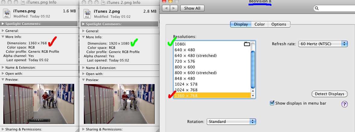

I always knew that my MacBook when attached to the BV8-32 gave me a higher desk top resolution that its native 1280x800 pixels.
I had also noticed there was a 1080i option when the BV8-32 was attached, but I had dismissed it because the desktop characters looked fuzzy or not as crisp.
The other day I tried the 1080i for showing video, and I captured two screen shots, and realised that the MacBook is certainly generating 1920x1080 images ... and that the MacBook "thinks" that the "Beovision 8" can handle them.
Does this mean the BV8-32 is secretly capable of handling 1080i ?

Maybe I'm not understanding the question right, but it's not a stealth thing. It's right on the website.
http://www.bang-olufsen.com/specifications?productid=26
8-32, 1080i.
8-40, 1080p.

dilznik:
au contraire:
BeoVision 8 - Specifications
BeoVision 8 - 40"
RESOLUTION |
1920 x 1080 pixels (Full HD), refresh rate 100/120Hz |
BeoVision 8 - 32"
RESOLUTION |
1366 x 768 pixels (HD-ready) |
So I think you have mixed your horizontals with your verticals, to quote some of the wikipedia entry:
1080i is the shorthand name for a format of high-definition video modes. 1080 denotes the number of horizontal scan lines—also known as vertical resolution—and the letter i stands for interlaced. In the alternate format of high-definition video mode, known as 1080p, the p would stand for progressive scan.
1080i is a high-definition television (HDTV) video mode. The term usually assumes a widescreen aspect ratio of 16:9, implying a horizontal resolution of 1920 pixels and a frame resolution of 1920×1080 or about 2.07 million pixels.
So the B&O site's description of 1366 x 768 pixels for the BV8-32 implies to me that it supports 720 p or i
I am happy to be corrected, but for me the mystery remains .......

Well, I'll just mix you up more
The "1080i/p" and "720i/p" here refer to the video signal. The spec sheet resolution figures 1920x1080 and 1366x768 refer to the actual panel. The TV will need to scale the image in many cases anyway, so it can quite well accept 1080i (or p) and display it on a 1366x768 screen, as these are two different things.
Now, whether the 8-32 can accept a 1080i signal, I'll be damned if I know

dilznik
- Joined on 09-19-2007
- Posts 357
elephant:
au contraire:
BeoVision 8 - 40"
RESOLUTION |
BeoVision 8 - 32"
RESOLUTION |
Yeah but they're Samsung panels. The Samsung "HD Ready" panels, like their TVs, are 1366x768 and handle 1080i and just compress it down to that resolution.
1080i isn't really 1920x1080 anyway. It's 1920 by 540 and then it transmits the 540 odd lines and then the 540 even lines.

dilznik:
Yes, I understand the interlace process which requires 1080 lines but for which for various processing or economic constraints its achieved in two steps.
You have an excellent point about the Samsung nature of the panels; clearly the Mac has produced the 1080 "bitmap" of some 2.6 megabytes. I will pick an area of small detail and see if I can detect just how much detail is lost at the display.
