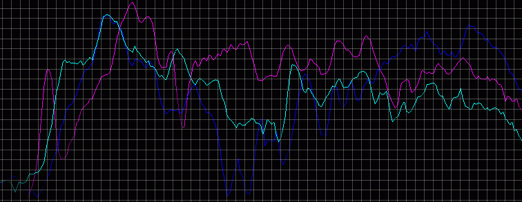

    I have these speakers few months and first thing I did was to measure them (I used smaart6) and one thing that I heard first and then confirm in measurements is that my speakers have boost in upper frequency section and big hole in mid bass part.It is surprisingly good in 40hz region tho.
    My question is:are B&O amplifiers flat or do they have some kind of equalization to match speakers,since speakers are far from flat.I was thinking on buying beomaster 5000,6000,6500 or something similar.In pic you may see Tannoy dmt 215 (pale blue),quested (pink) and Beovox s80.2 dark blue.
    Thank you

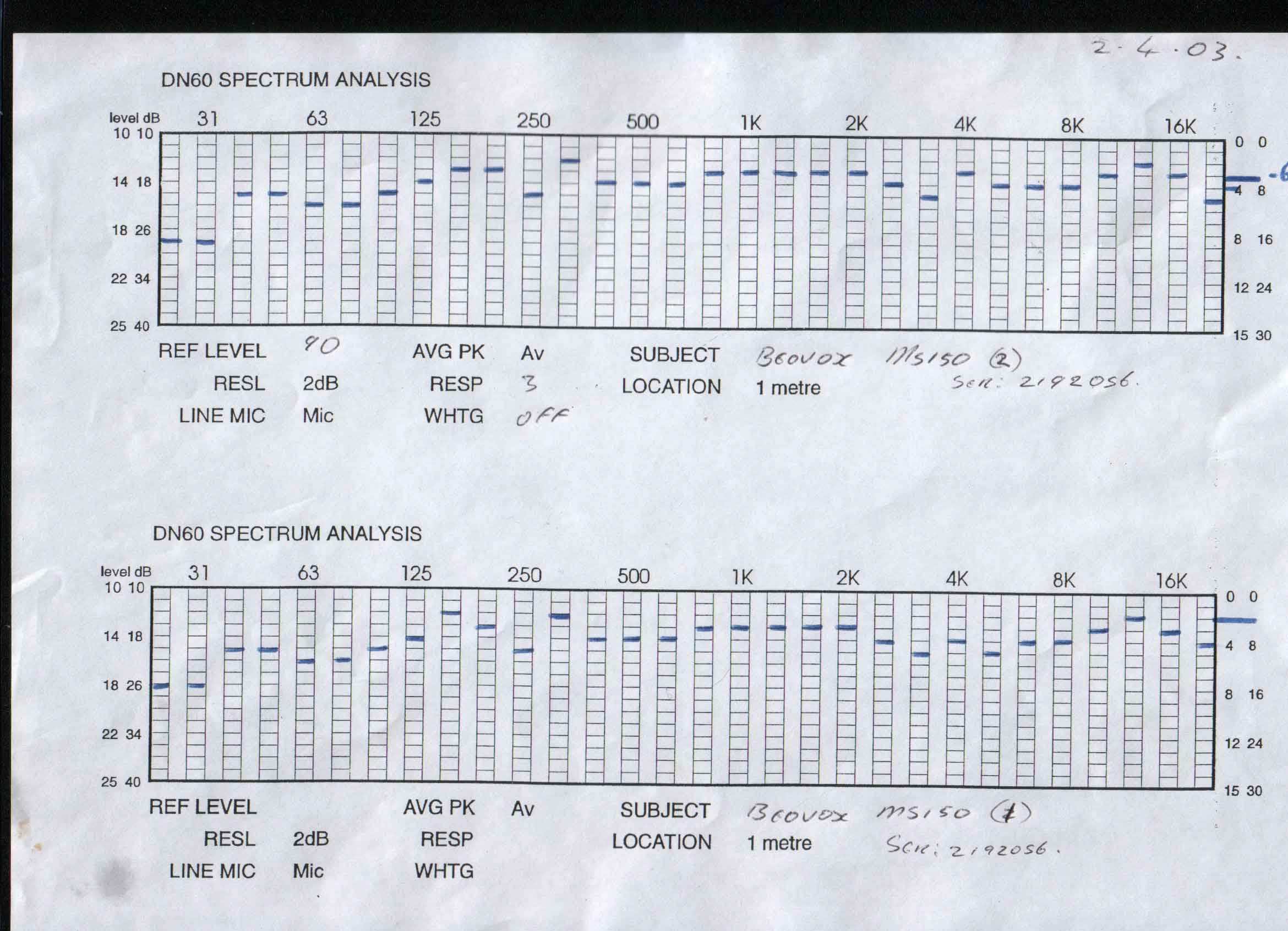

    I would suggest having a look at the cross over in the S80s. I dare say some replacing of capacitors could be in order. B&O speakers should offer a reasonably flat response - the amplifiers certainly do. I attach the responses of my MS150s as measured professionally.
    The best amplifier depends really on what you want. The 6000 is a good one as John says though rather prone to blowing one channel. My favourite is the 4400 but that too will probably need a little love and attention as it will be about 30 years old.

            Just in a case that you care,some drivers in my boxes were connected out of phase (mid frequency driver) so there was much canceling in those boxes since there is big overlap between 8" and 3" speaker and since they were out of phase almost whole spectar missed.Also there was some cancelation between mid and hi frequency speaker and that's the reason for hole in 4k section.
           Good thing that came out of this is that I started to think about beomaster 5000 or 6000,and now my problem is solved BUT I'm still thinking about some B&O amp.
           B&O not only in frequency domain rule but in also in phase...
           Thanks to everyone of you that responsed so quickly
           Martin Gajta
