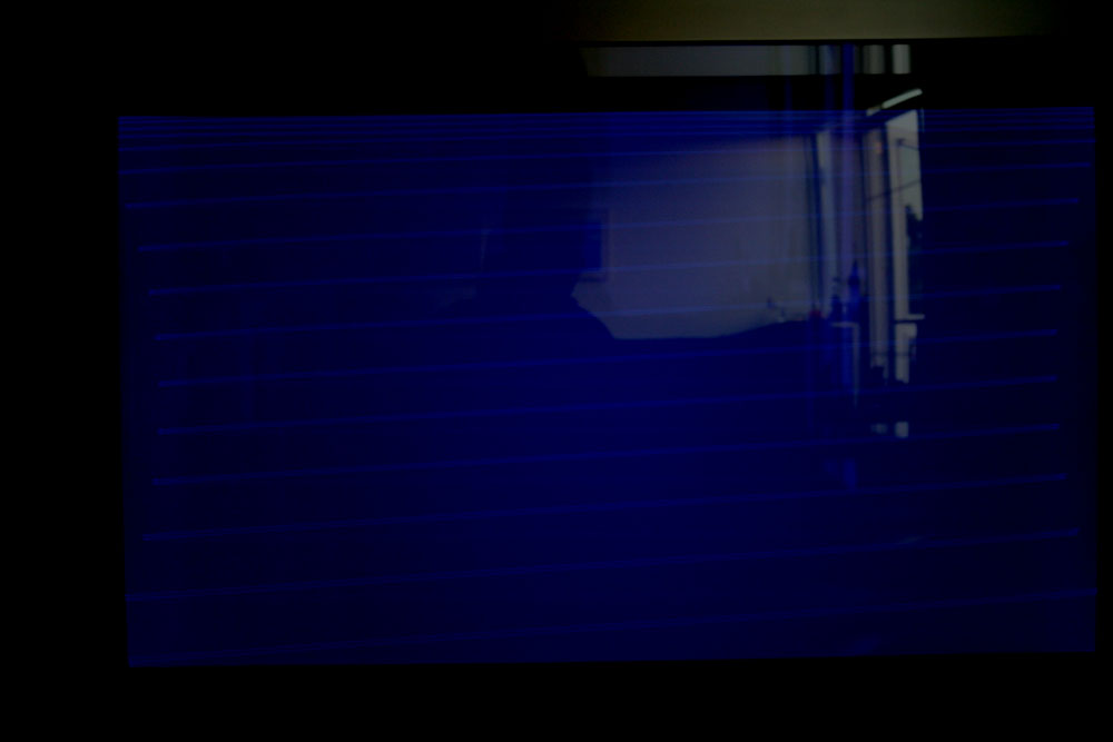

    Crying [:'(] Please tell me I do not have to buy a Beovision 7
    Please take a look at the attached photo from my Avant 100Hz (not RF).
    I see this picture everytime I should have a complete black screen; for instance between zapping stations or a minute or so after using AV-DVD or TV. Over the last half year this effect became stronger and stronger; I even see it sometimes during dark scenes in movies or tv shows. The effect concerns me and if this is an indication of my Avant going bad that would disappoint me since the avant is only 2198 days old!
    And I am not ready to buy a beovision 7 yet; because I think the BV7 looks great when switched off but does not impress me enough when turned on. I would like to wait a couple of years before making the jump to LCD.
    Who can tell me what I should expect for my Avant's life expectence?

    since it's only the blue, I think it's properly the tube. it's maybe possible adjust the G2 power to bay some time. But it's only going to gets wears from here on ,and at last powering down whit a bang, form the speaker in protection mode. Because the tube use to much power.
    You do Not have to buy a BV7... There are also BV9 Wink

     Thanks for the reply. To bad to hear that you also think this is "the start of the end". The BV9 is a good 'theoretical' option; but I would have to be lucky enough to win a lotery.
    But what do you mean by "form the speaker in protection mode"?

    Why don't you get your Avant repaired, if you don't want to change it?
     CRT tubes can be replaced, just like any electronic component.
     Your Avant is not so old and B&O spare parts can be available a long time after the product's commercial life is over.
    Your dealer should be able to fix your problem.

    Wha should I expect to pay in repair costs?
    In one of the previous responses it was mentioned that I could buy some time by reducing the G2 power. Is this something I can do myself? Would it help to adjust the settings under setup - picture adjustment (parameters like Bdr or Bcu)? I know the general advise is do not mess with the setup, but I guess if there is a time to do so, this might be it.
    I would like to buy as much time as possible because I am looking forward to the BV7 upgrade (hope the 32" will be updated soon).

    I've seen that sort of thing before. Not on B&O though - back when tellys were black and white, turning up the brightness way too high would generate exactly that effect. So I'd reckon something has gone out of adjustment, big style. As this has been developing slowly I'd hazard a guess at a component or two drifting out of spec. It'll need a service - it's not dying, it's just a bit poorly. No idea what the cost of that would be, but diagnosis should be easy and I'd expect the bill to be at the lower end of the scale rather than upper end - ie it should be more economical to fix it than to replace it.

    When it gets worse the current to the tube rises, and when it gets over 1 m.Amp. the TV goes in protection mode. and shots down. that resoles in a blob in the speakers.
    the G2 power is adjusted by a pot meter on Power supply, it call screen an sit next to the Focus pot meter witch also need to be adjusted afterwords..
    This can not bee change by the service menu do not change in that....

    I had the same problem with my Loewe.  I made an adjustment through a setting on the back of the TV, which fixed the problem.  (On my Loewe model, there were two adjustments outside of the service menu.)  I'm sorry I don't remember the exact setting, but it is worth a phone call to a technician, unless you are eager to purchase a replacement.

    A tube replacement is around EUR.1000, from what my dealer told me... The swap is definitly worth the price, except BV5 and BV9, there is no competitor to the Avant in the B&O range today...in my opinion!

    I have contacted my dealer and got a quick reply. He is very sure this problem is caused by the tube. He offered a tube replacement for a special price (660 euro); but I am not sure what to do. He also mentioned that I have to take care when I start to hear plopping noises since this might cause more damage.
    Not sure what to do; will visit my dealer on short notice to look at the options (in order of increasing costs):

    I would go for the repair option (660 euros). You won't regret your choice.
    IMHO, the BV7 picture's quality is far inferior than of the Avant TV.

    A special thanks to the Stig since he already mentioned the G2 power in the first reply (he also mentioned that this probably is a temporary solution; but I hope temporary means >1 year).
    One (hopefully) minor problem left to tackle on Monday; last Saterday I agreed to buy a second life Avant 32" RF DVD at my dealer. But I assume he will understand that I would like to cancel the order because his opinion was also that the tube needed replacement.
    Regards,
    Bieele

    My last post in this subject:
    Just talked with my dealer; it was no problem to cancel the order for the avant (Nice idea to have a good and trustworthy dealer).
    But his thought were similar to the Stig's: This is only temporary. Hopefully long enough to considere the beovision 7 update as an option (Please B&O update the 32" as well !!!).
    Regards,
    Bieele
    Heej zuij der alles veur gaeve En heej zaet ze mogen ut hebbe van meej

    Re: Please tell me I do not have to buy a Beovision 7
    Yesterday I had a big scare: The picture on my Avant turned black (with one small spot white in the middle) and immediately back to normal picture again. This took less then 1 second, but it scared me a lot. I thought this was the end of my tube; but it worked fine for the remainder of the day and today (so far).
    That's why I looked back to this post because I wanted to know how long ago I posted the 'blue striping' problem. It was nice to find out I 'fixed' this problem 1.5 years ago.
    Let's hope my telly holds up for at least another half year, because I still would not know what the best B&O tv to buy would be in the current range. I hope the fully spec'd BV8 will be a great product, or (keep dreaming) that I can find a great deal on a beosystem 3.
    Regards,
    Bieele
