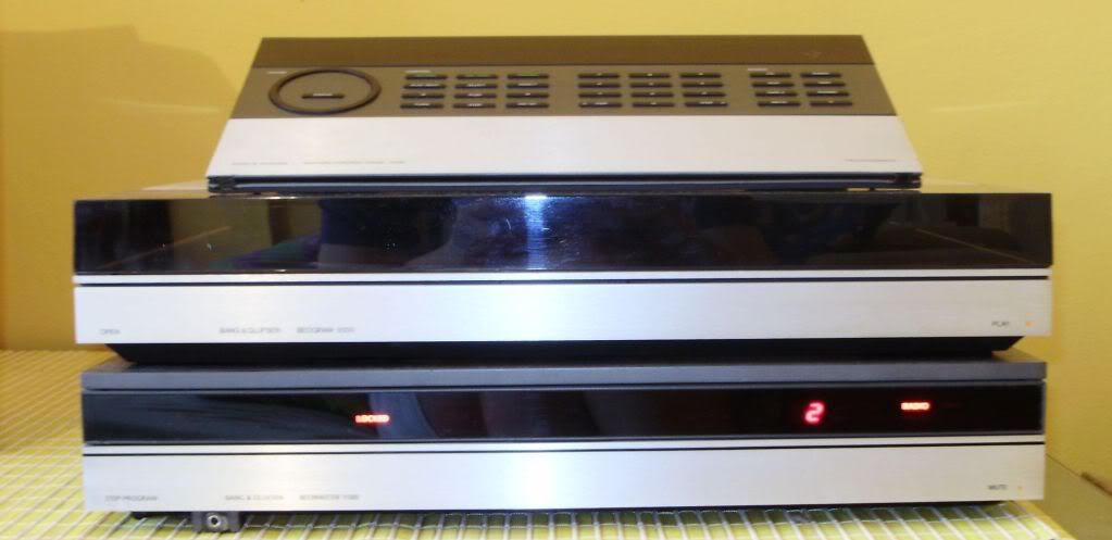

    Just working on this system (in alu/grey/black), too.
    For me a real B&O design classic.
    Got a BM 5500, a BG CD5500, a Beocord 5500, MCP 5500 AND a hifi rack for the Beosytem (original B&O).
    Got the floorstands for the RL speakers and now I am looking for some RL60.2s....
    Ralf
    PS: I also got a white Beosystem 5500 incl. the record player, but the BG CD5500 does not read CDs anymore, I suppose I will sell this one - but my wife will make the final (color) decision ;-). Based in Germany near Düsseldorf and pick-up only, though.
