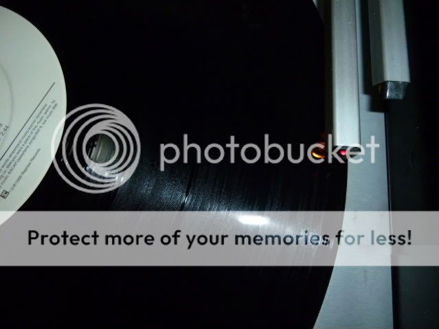

After some weeks of procrastination I have swapped the tachodisk, which solved one problem, but made it painfully obvious that I had to take care of the one next in line. Mainly the arm refusing to lower onto the vinyl, a rather annoying flaw when it comes to a turntable.
The arm stops at the exact same position, regardless of the size of record on the platter.
I have attempted the <</play workaround that some have posted in similar threads, but to no avail. And yes, this unfortunate behaviour also occurs with a stylus present.
