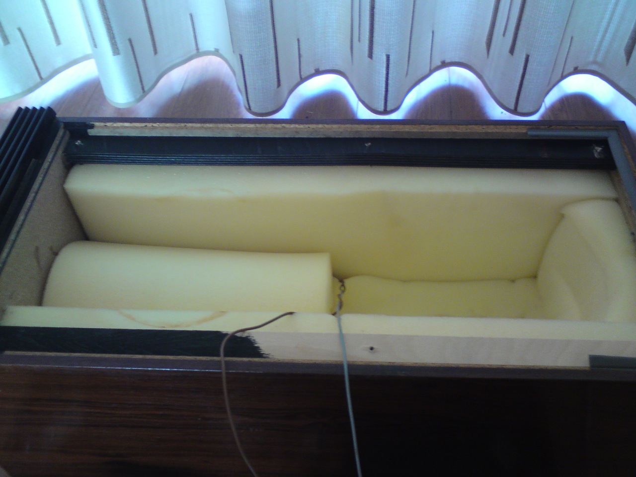

Thanks, will look into definetly. I will have to se where to get also the fire retardant acoustic foam to replace it with that scrap I found inside.

The foam looks original to me AFAIK.

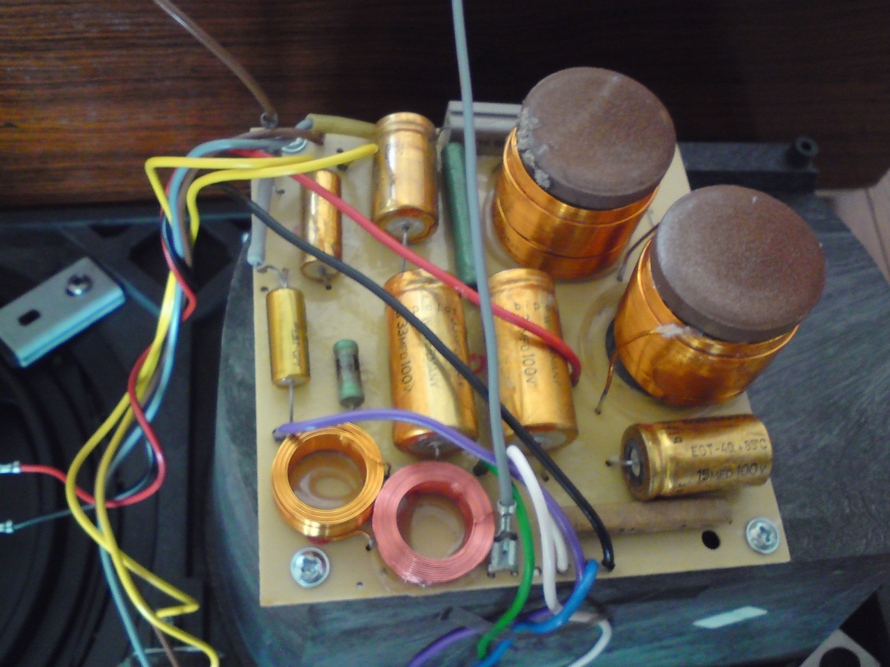

I have seen the speakers from Mr. Andy, on the pictures from the thread he linked few posts up. Here is the photo:
http://forum.beoworld.org/cfs-filesystemfile.ashx/__key/CommunityServer.Components.PostAttachments/00.00.03.82.02/P8120007.JPG
And the foam (actually sponge) has a heat burn from the coil on the circuit board, that is why I have a doubt.
Overall the speakers are not that bad, but the bass is really annoying me sometimes. I don't have an B&O impression if you get what I mean. Especially when I saw the woofers I am having inside it got somewhat clear to me why they do not sound so uniform.

You could both well be right, I've lost count of the different speakers of this era I've worked on over the years and all sorts of different damping materials have been used in them. Short of taking my MC120.s off the wall taking them apart I'll bow to your knowledge.

The foam in your MC120.2s looks exactly the same as the foam I found inside my speakers when I opened them up. The shapes, colour and texture look exactly the same. I wonder if B&O changed the specs at some point in the production run though, as Andy seems to have something a bit different in his.
Those Peerless woofers that I bought are excellent. After a few weeks of light use they were eventually well 'played in', and I can thoroughly recommend them to you! The bass is a bit more up front than with the original woofers, but my old ones were knackered so it's hard to say what they would have sounded like had I bothered to refoam the originals instead.

I could agree with Mr. Andy as from what I have seen from his photos and on the internet while googling that "fluffy", fiber stuffing is the correct one for these speakers. It doesn't take as much of volume as the sponge, atleast, as it is not as dense.
Also, as mentioned, the sponge is burned form the coil on the back of the mid-high enclosure. I doubt B&O would put something inside that is melting with the temperature increase. Most, if not all of this stuffings on the market are fire retardant.
That is just my opinion. Anyway, I doubt that distortion of the bass is coming from the sponge, it is just the cheap driver that is installed.

Perhaps B&O changed the foam at the .2 update. My S80.2 have exactly the same yellow foam that yours has in them too, and I have seen other photos with the same foam (John's included) so i suspect it might be standard.

I replaced mine with Peerless drivers a long time ago and was happy with the results. Mine were S120s and can be seen with the new drivers here. Mine were a fairly unpleasant teak colour unlike the lovely rosewood that yours are. Mine had the tatty foam like yours - my older Beovox speakers have more of a blanket type filling.
